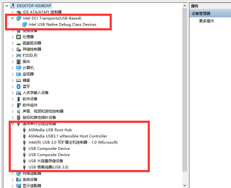

USB设备: image description

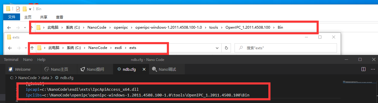

ndb.cfg配置文件和EXDI和IPC路径: image description

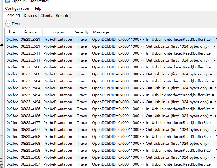

ndb.cfg配置文件和EXDI和IPC路径: image description OPENIPC里也是有信息的。被调试机器开关机,也是能接受到事件。 image description
关机事件: 00:21:56#EXDI:StartNotifyingRunChg3 00:27:23#JTGE:JtagReconfigurationEvent:type=2 dbgportid=1 00:27:23#JTGE:JtagMessageEvent:type=1 dbgportid=Failed to establish target connection. The OS was unable to communicate with the debug hardware. The target may need to be power cycled. Error: (Error: 0x0016000e) 00:28:06#JTGE:JtagMessageEvent:type=2 dbgportid=DCI: Device Gone (Target Power Lost or Cable Unplugged)
开机事件: 00:28:06#JTGE:JtagReconfigurationEvent:type=1 dbgportid=0 00:28:06#JTGE:JtagReconfigurationEvent:type=2 dbgportid=1 00:28:21#JTGE:JtagMessageEvent:type=2 dbgportid=DCI: A DCI device has been detected, attempting to establish connection 00:28:23#JTGE:JtagReconfigurationEvent:type=1 dbgportid=0 00:28:23#JTGE:JtagReconfigurationEvent:type=2 dbgportid=1 00:28:23#JTGE:JtagMessageEvent:type=1 dbgportid=Failed to establish target connection. The OS was unable to communicate with the debug hardware. The target may need to be power cycled. Error: (Error: 0x0016000e) 00:28:23#JTGE:JtagMessageEvent:type=2 dbgportid=DCI: Device Gone (Target Power Lost or Cable Unplugged) 00:28:23#JTGE:JtagReconfigurationEvent:type=1 dbgportid=0 00:28:23#JTGE:JtagReconfigurationEvent:type=2 dbgportid=1 00:28:23#JTGE:JtagMessageEvent:type=2 dbgportid=DCI: A DCI device has been detected, attempting to establish connection 00:28:25#JTGE:JtagReconfigurationEvent:type=1 dbgportid=0 00:28:25#JTGE:JtagReconfigurationEvent:type=2 dbgportid=1 00:28:25#JTGE:JtagMessageEvent:type=1 dbgportid=Failed to establish target connection. The OS was unable to communicate with the debug hardware. The target may need to be power cycled. Error: (Error: 0x0016000e) 00:28:29#JTGE:JtagMessageEvent:type=2 dbgportid=DCI: Device Gone (Target Power Lost or Cable Unplugged) 00:28:29#JTGE:JtagReconfigurationEvent:type=1 dbgportid=0 00:28:29#JTGE:JtagReconfigurationEvent:type=2 dbgportid=1 00:28:29#JTGE:JtagMessageEvent:type=2 dbgportid=DCI: A DCI device has been detected, attempting to establish connection 00:28:31#JTGE:JtagReconfigurationEvent:type=1 dbgportid=0
